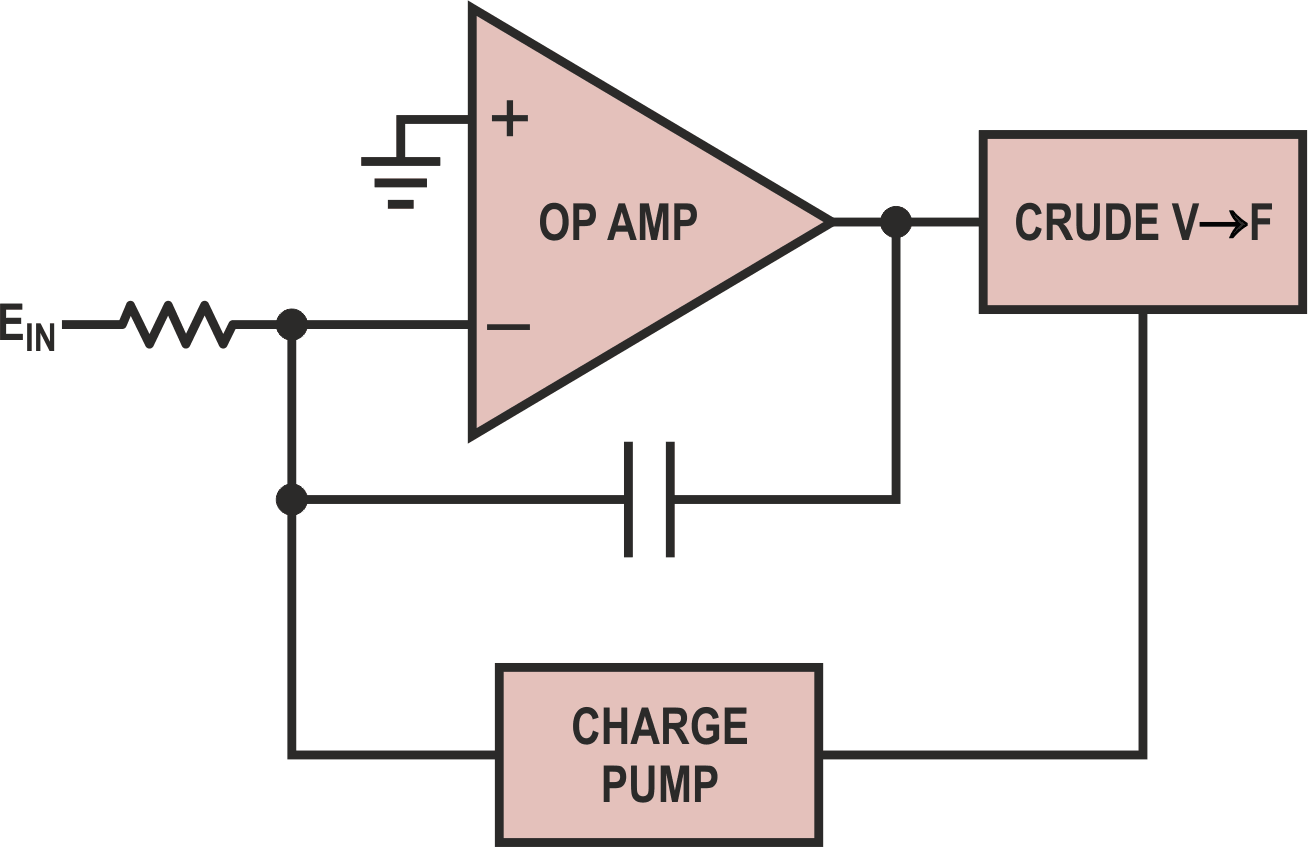

Nearly four decades ago (in his "Designs for High Performance Voltage-to-Frequency Converters", Ref. 1), famed designer Jim Williams cataloged five fundamental techniques for voltage to frequency conversion. One of those five is reproduced in Figure 1.
| Figure 1. | Precision charge pump closes feedback loop to make “crude V→F” accurate from “Designs for High Performance Voltage-to-Frequency Converters”. |
Williams concisely summarizes how this famous topology works: “The DC amplifier controls a relatively crude V→F. This V→F is designed for high speed and wide dynamic range at the expense of linearity and thermal stability. The circuit’s output switches a charge pump whose output, integrated to DC, is compared to the input voltage. The DC amplifier forces V→F operating frequency to be a direct function of input voltage.”

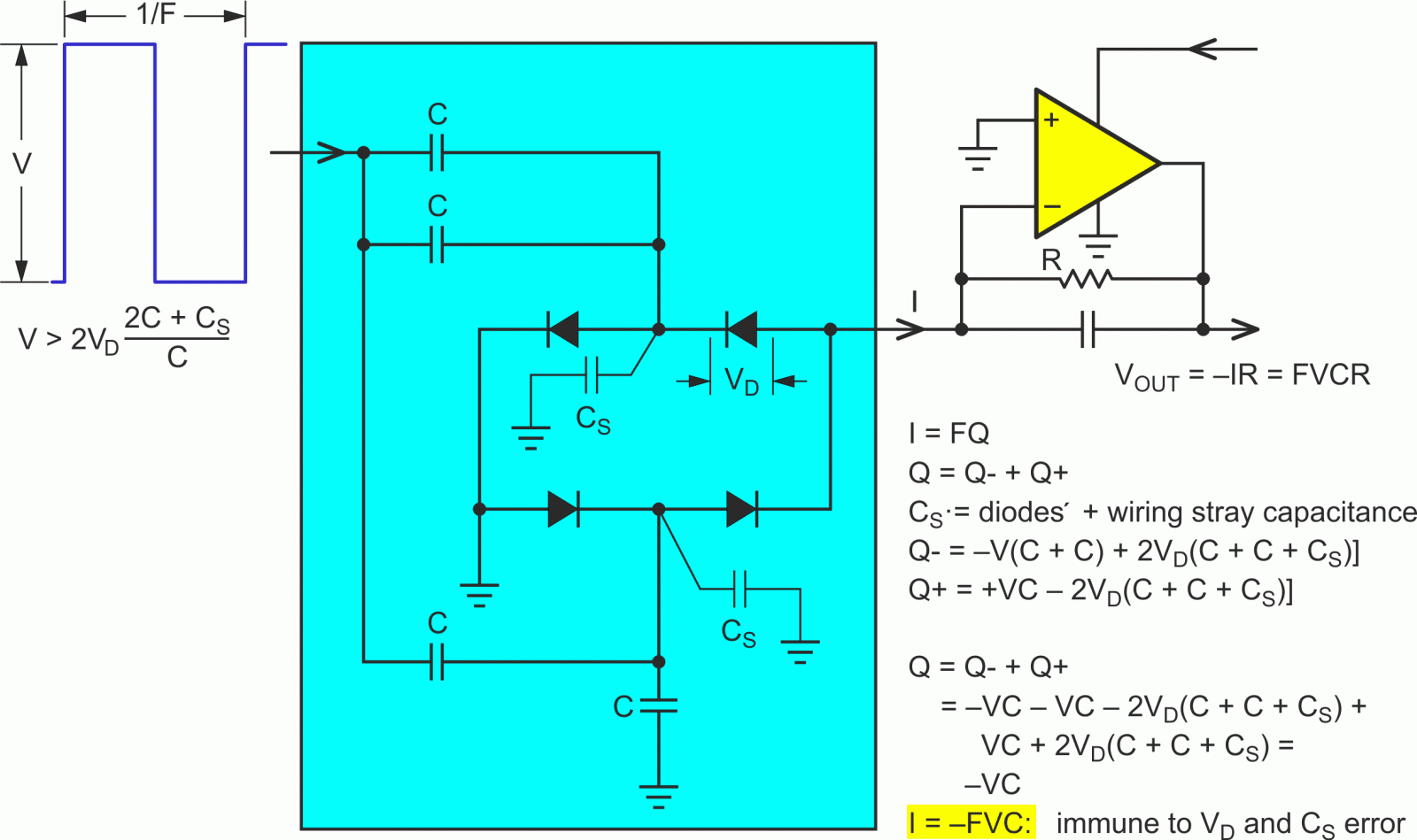

Figure 3 shows an approach that’s entirely different from reference tweaking: “Take-Back-Half”, or TBH!
| Figure 3. | TBH adds a half-amplitude reverse-polarity pump that subtracts error terms. |
TBH adds a new opposite-polarity pump in parallel with the usual diode pair, driven by a 1:2 ratio capacitive voltage divider with the same total capacitance. The result is to generate opposing charge packets that have half the nominal signal amplitude but equal error signal amplitude. Consequently, when the charges are summed, half the desired signal is “taken back” from the net pump output, but all the error goes away.
This leaves only the original, ideal-diode-case output:
Q = –VC
and
VOUT = FVCR.
This verbiage might sound garbled and confusing (I know) but the analog algebra is simple and (I hope) clear. Please see Figure 3.
