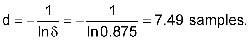

- Choose the parameter F. For assembler, it is convenient to perform division as right shifts. For right shifts, the value of F should be 2S, where S is the number of shifts. Let F equal 8, which you reach after three right shifts.
- Calculate the decrement:
- Calculate the time constant as
The equation
