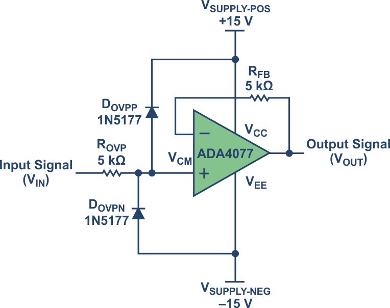

A very popular way to add OVP is shown in Figure 1. When the amplitude of the input signal (VIN) exceeds one of the supply voltages plus the forward voltage of a diode, the diode (DOVPP or DOVPN) will forward bias and send the current to the supply rails rather than into the op amp inputs where the excess current could damage the op amp. In this application, we are using an ADA4077, an extremely high precision op amp with a maximum power supply range of 30 V (or ±15 V).
| Figure 1. | Classic clamping circuit for overvoltage protection. |
The clamping diodes are 1N5177 Schottky diodes because they have a forward voltage of approximately 0.4 V, which is less than the forward voltage of the of the op amp's input electrostatic discharge (ESD) protection diodes; thus, the clamping diodes will start conducting current before the ESD diodes do. The overvoltage protection resistor, ROVP, limits the forward current through the clamping diodes to keep them under their maximum current rating, preventing them from being damaged by excessive current. The resistor RFB in the feedback loop is there because any input bias current on the noninverting input can cause an input voltage error across ROVP – adding RFB will null out the error by generating a similar voltage on the inverting input.

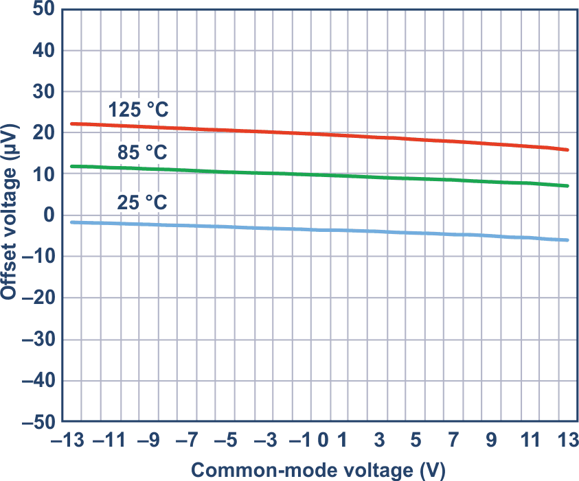

| Figure 2. | Input offset voltage vs. input voltage for ADA4077. |

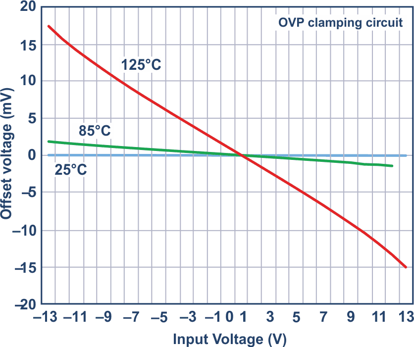

Of additional concern is that diode reverse leakage current increases exponentially with an increase in temperature, causing an increase in the offset voltage penalty of the clamping OVP circuit. As a baseline of comparison for op amp precision with no external overvoltage circuitry, Figure 2 shows the measured offset voltage of the ADA4077 over an input voltage range from –13 V to +13 V. The measurements were performed at three temperatures: 25 °C, 85 °C, and 125 °C. Note that at 25 °C, the VOS of the ADA4077 used in this test reached only 6 µV; even at 125 °C, the VOS is only approximately 20 µV. When we add the external clamping OVP circuit to the same ADA4077 device and apply the input at VIN, we see the results shown in Figure 3. At room temperature, the VOS jumps to 30 µV – five times the signal path error of the ADA4077 alone. At 125 °C, VOS goes to over 15 mV – an increase of 750 times the 20 µV of the ADA4077! Precision is gone.
| Figure 3. | Input offset voltage vs. input voltage for an OVP clamping circuit added to ADA4077. |
The 5 kΩ resistor does a great job protecting the clamping diodes as well as the op amp during an overvoltage condition but it adds quite a bit of offset error during normal operation when the diodes are leaking current across it (not to mention Johnson noise from the resistor). What we would like is a dynamic input resistance that has low resistance during operation within the specified input voltage range but high resistance during overvoltage conditions.

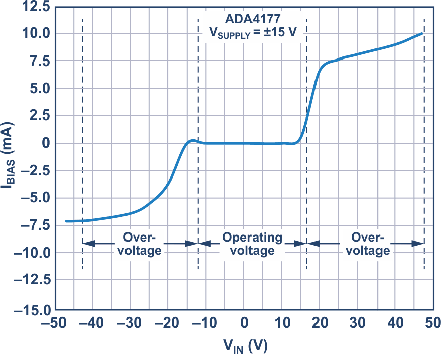

The ADA4177 is a high precision op amp that includes integrated overvoltage protection. The integrated ESD diodes act as overvoltage clamps to protect the part. Depletion mode FETs are in series at each input before the ESD diodes. They provide the dynamic resistance, which increases when the input voltage (VCM) exceeds the supply voltages. As input voltage increases, the drain-to-source resistance (RDSON) of an internal FET increases, thus restricting the current flow exponentially with the increased voltage (shown in Figure 4). Because the ADA4177 uses depletion mode FETs on the inputs and not a series protection resistor, the op amp doesn't suffer the offset voltage penalty across the resistor that the clamping OVP circuit does.
| Figure 4. | ADA4177 input bias current is restricted as overvoltage increases. |

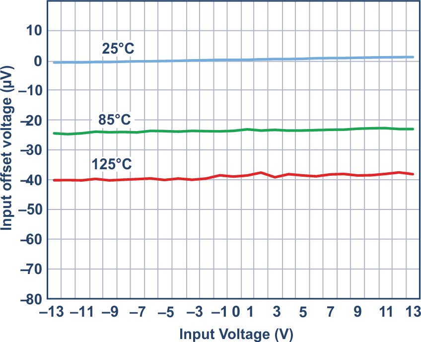

The ADA4177 can withstand voltages on its inputs of up to 32 V beyond the supply voltage. It limits overvoltage current to a typical 10 mA to 12 mA, protecting the op amp without the use of any external components. As shown in Figure 5, even at 125 °C this tested unit is showing an offset voltage of only 40 µV. That's less than 3% of the error that the clamping circuit showed at that temperature. Precision is maintained!
