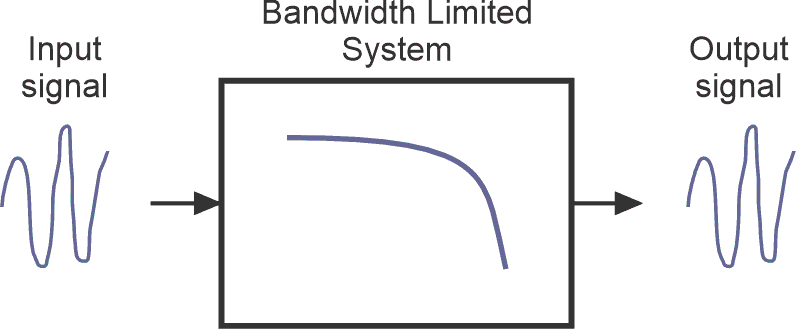

Figure 1 shows a signal passing through a system with finite bandwidth. As shown, there is enough bandwidth in the system to pass the signal unchanged, which is typically the desired outcome. Of course, if the frequency content of the signal exceeds the bandwidth of the system, the output signal can be significantly degraded.
Although this system has a limited bandwidth (low-pass filter), it has sufficient bandwidth to pass the signal undistorted.
Figure 1. Although this system has a limited bandwidth (low-pass filter),

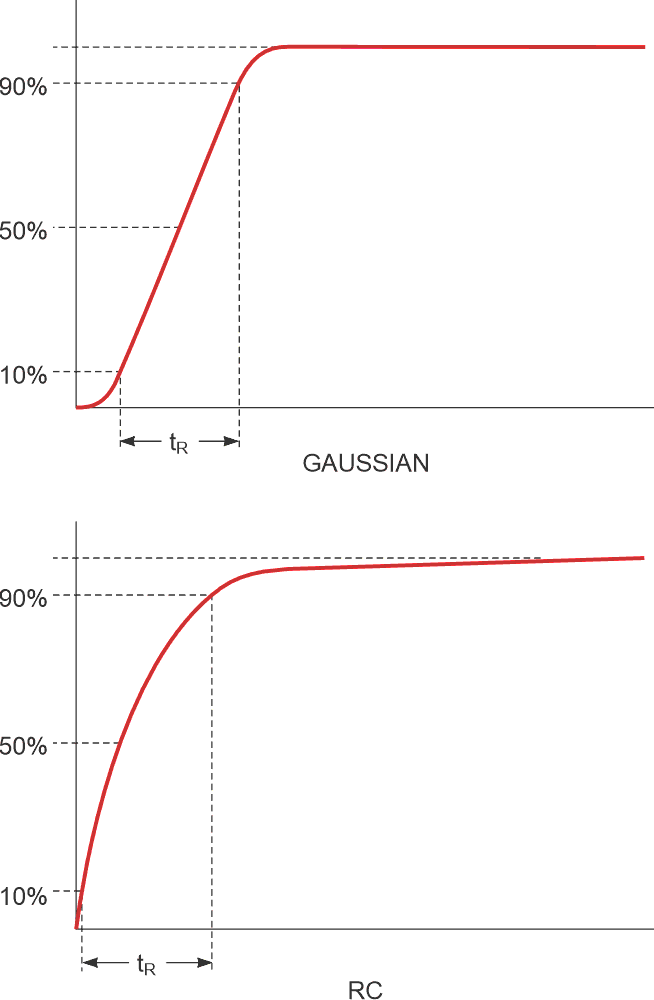

This equation is exact for a system with a single-pole low-pass response (think “low-pass RC circuit”) and it's reasonably close for many well-behaved systems [Ref. 2]. I recently found an old Tektronix article [Ref. 3] that discussed vertical amplifier response and rise time. The article showed these two plots of step response, one for the idealized “gaussian response” and the other for a classic lowpass RC circuit (Figure 2).
Gaussian step response and a lowpass RC circuit step response. Source: Reference 2.
Figure 2. Gaussian step response and a lowpass RC circuit step response. Source: Reference 2.
I found the associated comments interesting because they describe the design tradeoff between rise time and overshoot. (The factor K corresponds to 0.35 from the equation above):
A true gaussian response resolves to tR·BW = 0.32. Because of several factors oscilloscope amplifiers don't meet the requirement for true gaussian response. “Gaussian” circuits are thus essentially gaussian. Empirical products, arrived through years of research, define these “gaussian” circuits. For a higher gaussian response, tR·BW = 0.35 to 0.45. Higher products indicate least risetime. However, overshoot accompanies the risetime reduction. A product of 0.45 results in 5% overshoot and when tR·BW = 0.35 there is little, if any, overshoot in the step response. Tektronix usually established the product at K = 0.35, sacrificing risetime for minimum overshoot.
K is a figure of merit and is sometimes referred to as the Rise Time Bandwidth Product (RTBP). In recent years, as oscilloscope manufacturers have pushed the upper limits of usable bandwidth, they have sometimes implemented a steeper roll off of the instrument response with a corresponding shift in the RTBP. For example, the Keysight UXR 110 GHz oscilloscope uses a factor of 0.44 to specify the 10%/90% rise time [Ref. 4]. (For a deeper dive into oscilloscope frequency response, see Ref. 5.)

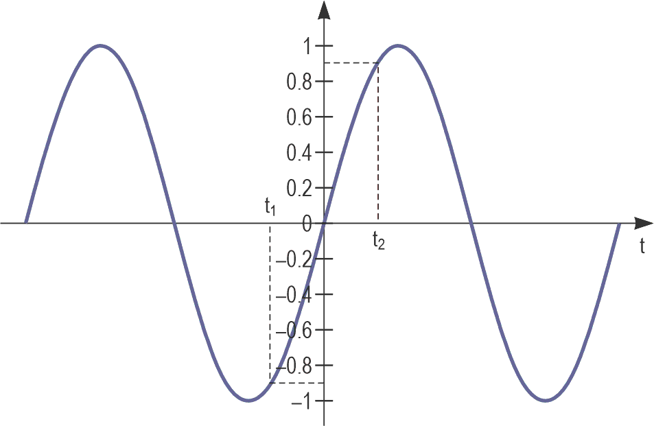

After looking at the digital case, I kept thinking about the simple sinewave. Rise time is most applicable to step functions or square waves but it can be applied to a sine wave (although I admit it may seem a bit contrived). Consider a sine wave with an amplitude of 1 and a peak-to-peak amplitude of 2 (Figure 3).
v(t) = sin(2πft)
In this example, the rise time of a sine wave is calculated as the time between 10% and 90% of peak-to-peak amplitude.
Figure 3. In this example, the rise time of a sine wave is calculated as the time

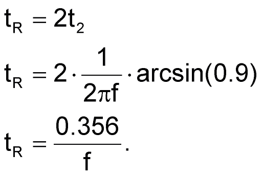

Let’s calculate the “rise time” as the time it takes for the waveform to go from 90% of the negative peak to 90% of the positive peak. As shown in the figure, this rise time will be t2 – t1. Due to the symmetry of the waveform, we see that
Well isn’t that interesting. The same value of 0.35 pops up as the relationship between the frequency and the rise time of the sinewave. A careful look reveals that it is slightly different: 0.356 versus 0.350 for the single-pole case [Ref. 1]. There seems to be something special about the number 0.35 but not to the level of being a universal constant (e.g., the speed of light).
