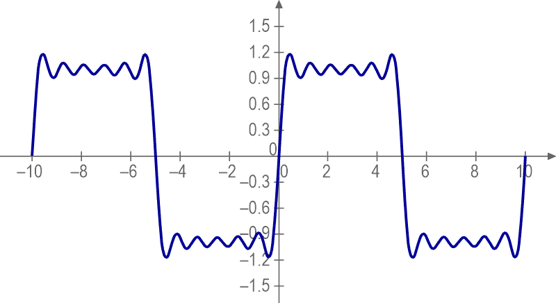

Each additional harmonic produces a waveform that looks more like a square wave. We won't plot all of them in Table 1, but Figure 5 shows the waveform out to the 11th harmonic. Higher-order harmonics make the waveform more square and leave higher frequency ripples in the flat parts of the waveform.
График сигнала, включающего частотные составляющие вплоть до 11-й гармоники, становится значительно ближе по виду к прямоугольному импульсу.
Figure 5. A plot of the waveform including frequency content up to the 11th harmonic
gets considerably closer to looking like a square wave.
Adding in a specific number of harmonics is equivalent to applying a brick-wall low-pass filter in the frequency domain. The desired harmonics are included in the waveform and the higher harmonics are eliminated. This is somewhat artificial because in the real world, we would probably have a frequency response than rolls off gradually with some remnants of the higher harmonics still present.
