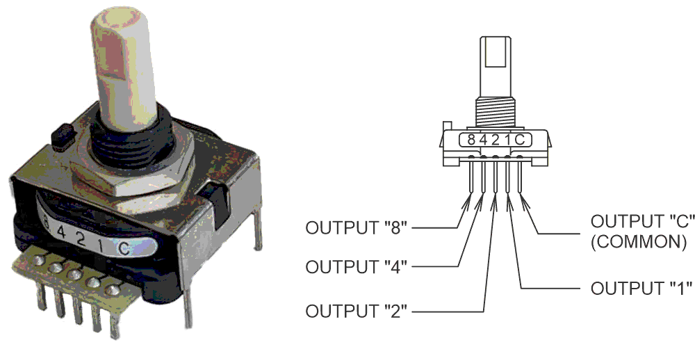

Shown in Figure 1 is a 4-bit Gray code output rotary encoder. As can be seen, it has four output terminals labeled 1, 2, 4, and 8, along with a Common terminal. The numbers 1-2-4-8 represent the bit positions in a 4-bit code, with each terminal corresponding to one output line of the encoder. As the rotor turns, each line switches between high and low according to the Gray code sequence, producing a unique 4-bit pattern for every position.
Datasnip shows terminal ID of the 25LB22-G-Z 4-bit Gray code encoder.
Figure 1 Datasnip shows terminal ID of the 25LB22-G-Z 4-bit Gray code encoder.
The Common terminal serves as the reference connection – typically ground or supply return – against which the four output signals are measured. Together, these terminals provide the complete Gray code output that can be read by a controller or logic circuit to determine the encoder’s angular position.
