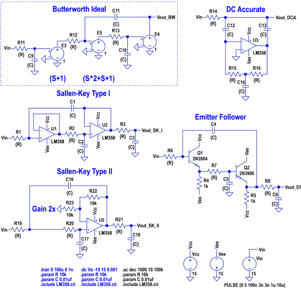

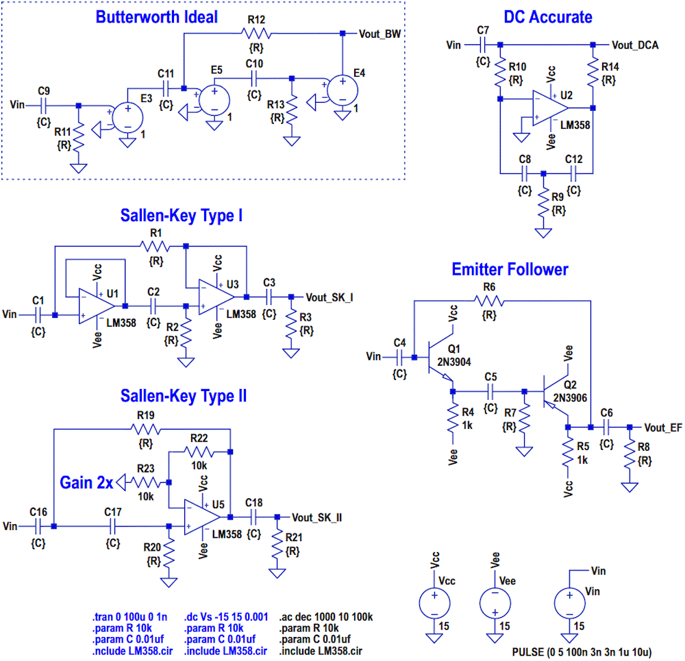

Figure 1 shows the various forms of these low-pass filters for simulations, including an ideal filter version with the Butterworth transfer function.
The various third-order active Butterworth response low-pass filters discussed in this Design Idea include ideal, Sallen-Key Type I and II, emitter follower and DC accurate variants.
Figure 1. The various third-order active Butterworth response low-pass filters discussed in this Design Idea include ideal,

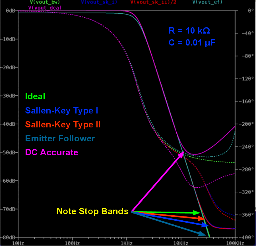

Figure 2 shows LTspice AC simulation results, illustrating the limitations of the op-amp output impedance on the stop-band rejection. Note that the emitter follower version has slightly less than unity gain and a slight deviation from the ideal response, as expected.
In these LTspice linear AC low-pass filter simulations, note the stop band attenuation limits due to op-amp model finite output impedance.
Figure 2. In these LTspice linear AC low-pass filter simulations, note the stop band

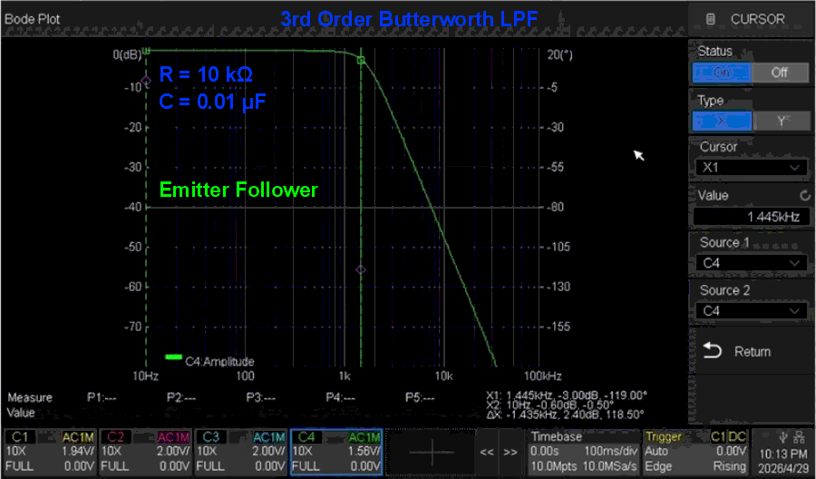

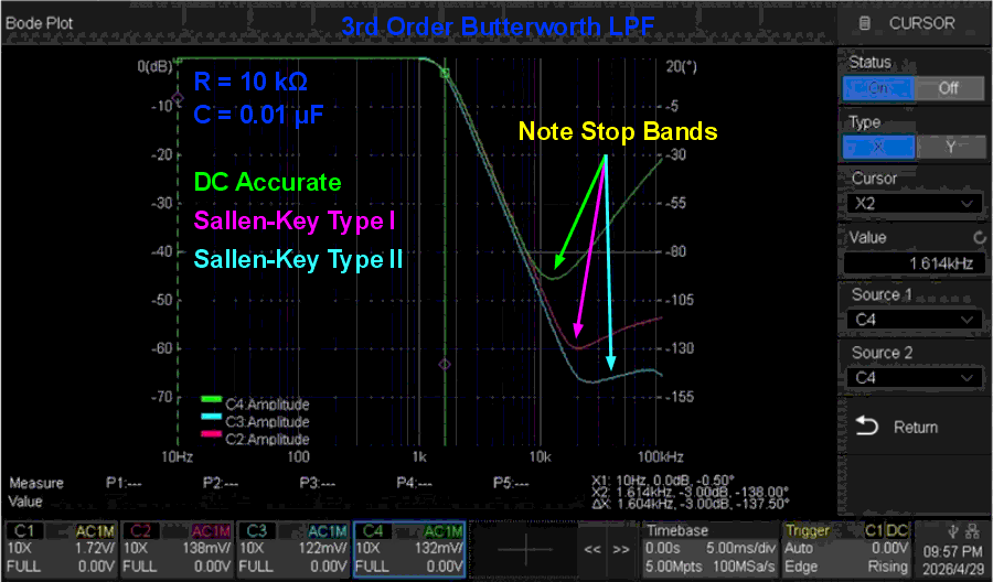

Figures 3a and 3b show actual lab measurements performed with a DSO (digital storage oscilloscope)/AWG (arbitrary waveform generator) combination, utilizing the built-in Bode feature, for various low-pass filters. Compare them with the previous simulations shown in Figure 2, and note the stop band limitations due to the finite op-amp output impedance.
Low-pass filter Bode measurements in the lab show stop band effects due to physical op-amp output impedance limitations (a, left). In the emitter follower version's Bode plot, note that the DC gain is -0.6 dBV (b, right). Low-pass filter Bode measurements in the lab show stop band effects due to physical op-amp output impedance limitations (a, left). In the emitter follower version's Bode plot, note that the DC gain is -0.6 dBV (b, right).
Figure 3. Low-pass filter Bode measurements in the lab show stop band effects due to physical op-amp output impedance
limitations (a, left). In the emitter follower version’s Bode plot, note that the DC gain is –0.6 dBV (b, right).

Now, lets swap the resistors and capacitors in each filter topology, thereby transforming each filter from a low-pass to a high-pass version (Figure 4). The only filter to complete this transformation with any negative effects whatsoever is the DC accurate version. With this particular filter, the DC isolation due to the shunt capacitors is now replaced with shunt resistors, which obviously couple the op-amp input and output offset to the filter output. Otherwise, this filter, like its peers, behaves as expected in its high-pass form.
Swapping resistors and capacitors results in high-pass versions of the circuits previously seen in Figure 1.
Figure 4. Swapping resistors and capacitors results in high-pass versions of the circuits previously seen in Figure 1.

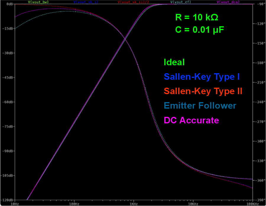

Figure 5 illustrates the simulation results with the resistor and capacitor swaps made to each previous filter type, thereby transforming it from a low-pass to a high-pass filter with the same characteristic (i.e., Butterworth) and 3 dB corner of 1/(2πRC).
Shown here are simulations of the high-pass filter derivations of Figure 1's circuits, i.e., the circuits shown in Figure 4, in each case achieved by swapping resistors (R) and capacitors (C).

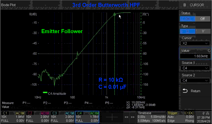

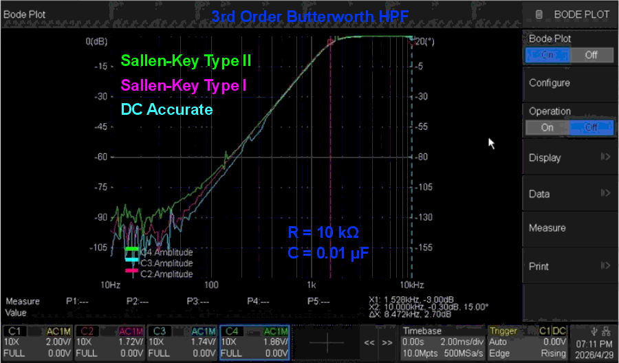

Figure 6a and 6b are actual lab measurements which reveal some of the measurement setup and equipment limitations in dynamic range at the low-frequency end.
In these lab-based Bode high-pass filter measurements (again, a at left, b at right), note the dynamic range limitations at lower frequencies. In these lab-based Bode high-pass filter measurements (again, a at left, b at right), note the dynamic range limitations at lower frequencies.
Figure 6. In these lab-based Bode high-pass filter measurements (again, a at left, b at right), note the dynamic range limitations
