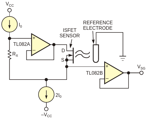

This circuit is a …
This circuit is a classic configuration for biasing ISFET sensors
S Casans, AE Navarro, D Ramirez
Circuit forms novel floating current source
Figure 1
20 Kb
Figure 1. This circuit is a classic configuration for biasing ISFET sensors
Figure 2. This novel floating current source represents an improved way to bias ISFET sensors
Figure 3. Very small measured errors appear in the ISFET's bias current
Figure 4. Only a few millivolts of error appear over the full range of V
DS
