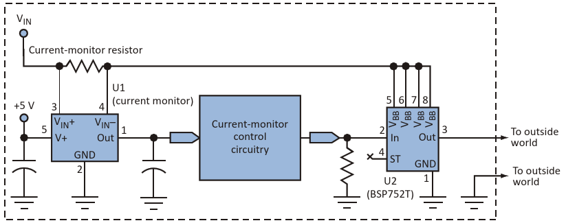

To protect the current-monitor …
To protect the current-monitor resistor from a field-wiring error that could cause a short circuit, this circuit feeds the current from the resistor to a self-protected high-side driver's V

Unconventional Use Of An Output Driver Protects Current Monitor
Figure 1
