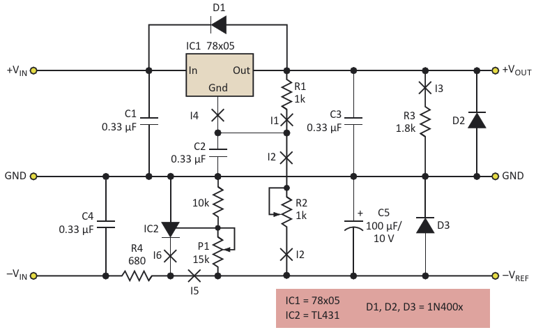

Drive LDOs To 0-V Output With Single Supply

Figure 4. A similar approach works with the 78xx family, but requires a change in the details of the circuit topology
