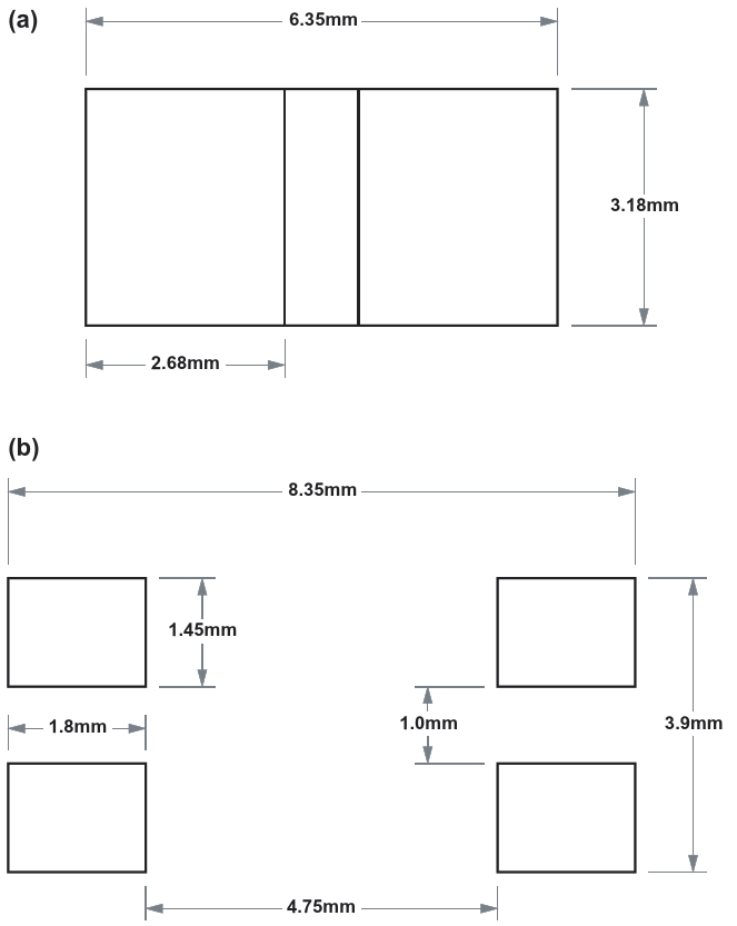

(a) ULRG3-2512-0M50-FLFSLT resistor dimensions; …
(a) ULRG3-2512-0M50-FLFSLT resistor dimensions; (b) Standard 4-pad footprint

Optimize High-Current Sensing Accuracy by Improving Pad Layout of Low-Value Shunt Resistors
Figure 2. (a) ULRG3-2512-0M50-FLFSLT resistor dimensions; (b) Standard 4-pad footprint
