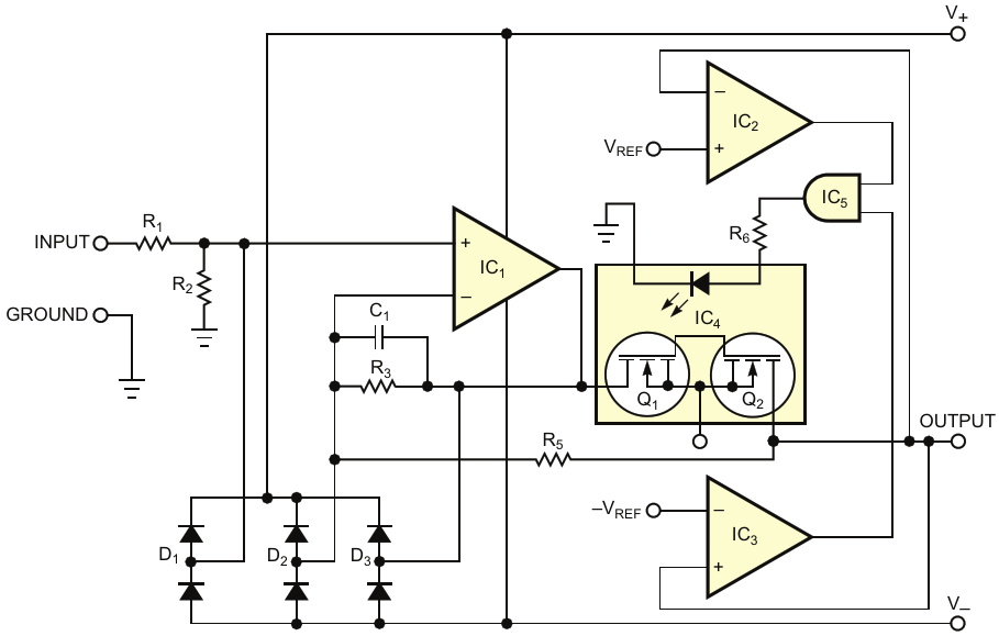

Figure 3. This series-protection circuit disconnects the amplifier-output terminal using a series-connected, high-voltage SSR
