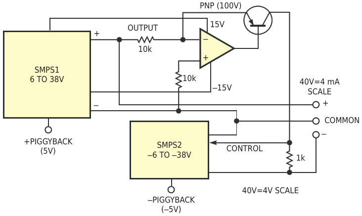

The switch-mode power supplies …
The switch-mode power supplies track each other with opposite-polarity outputs
Vijay Damle
Keep the heat down in power op amps
Figure 2
12 Kb
Figure 1. Power supplies track the input signal in bootstrap fashion, thus reducing power dissipation
Figure 2. The switch-mode power supplies track each other with opposite-polarity outputs
