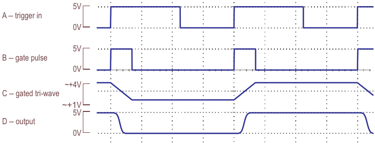

Waveforms after adding the …
Waveforms after adding the mods shown in Figure 4

Figure 5. Waveforms after adding the mods shown in Figure 4
