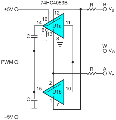

PWM drives opposing-phase CMOS switches and RC network to simulate a Dpot
Stephen Woodward
PWMpot approximates a Dpot
Figure 1
10 Kb
Figure 1. PWM drives opposing-phase CMOS switches and RC network to simulate a Dpot
Figure 2. The PWMpot's equivalent circuit where r = switch R
ON
, P = PWM duty factor, and where the ripple filter capacitors are not shown
