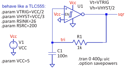

An RC oscillator modeled with QSPICE's built-in behavioral Schmitt trigger, it is a TLC555 (CMOS 555)

Figure 1. An RC oscillator modeled with QSPICE's built-in behavioral Schmitt trigger, it is a TLC555 (CMOS 555)
Figure 2. The typical triangle wave input and the square wave output, where the average power dissipation of R1 is around 6 mW
Figure 3. Schmitt trigger oscillator, this time, with the parameter stepping of R1, the .meas commands for period and frequency measurement, and an auxiliary circuit that triggers AbortSim()
Figure 4. Frequency versus potentiometer resistance curve in a log plot, interpolated over 100 measurement points
Figure 5. Hacked Schmitt trigger oscillator with an expanded Figure 1 circuit that includes R2=RPOT in series with C1
Figure 6. The typical triangle wave input with the output now reaching very high frequencies without excessively loading V(OUT)
Figure 7. Frequency versus potentiometer resistance curve in a log plot, interpolated over 100 measurement points, showing a flatter curve profile and larger tuning range
Figure 8. Frequency versus potentiometer resistance curve in a log plot, interpolated over 100 measurement points, showing a flatter curve profile and larger tuning range
