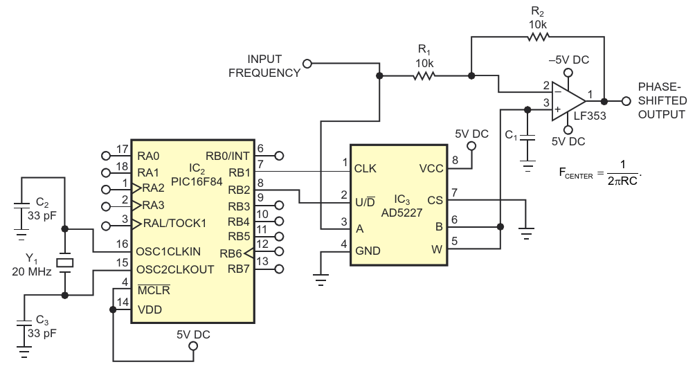

A PIC16F84 sets the …
A PIC16F84 sets the resistance of the AD5227 digital potentiometer, precisely controlling the phase shift of the output with respect to the analog input
Nick Ierfino
Microcontroller controls analog phase shifter
Figure 1
