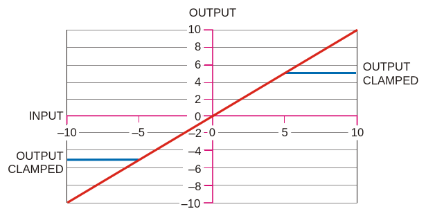

set at -5 V, the output clamps firmly at ±5 V
Circuit forms adjustable bipolar clamp
Figure 2
11 Kb
Figure 1. This circuit provides adjustable clamping over the range of ±1 to ±10 V
Figure 2. With V
CLAMP
