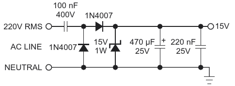

This charge pump feeds …
This charge pump feeds the twilight switch from the ac line with high efficiency
Carlos Castro-Miguens, José Benito Castro-Miguens
Switch circuit controls lights
Figure 1
13 Kb
Figure 1. This charge pump feeds the twilight switch from the ac line with high efficiency
Figure 2. The circuit uses a light-dependent resistor to measure the ambient-light level
