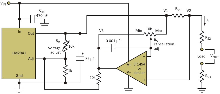

This variation of the circuit provides negative feedback for regulators that use a ground-referred reference voltage, like the LM2941

Circuit cancels interconnection resistance to enhance load regulation

Figure 1. By developing a correction voltage using a separate current-sampling resistance, designers can eliminate the added circuitry of the four-wire Kelvin connection
Figure 2. This variation of the circuit provides negative feedback for regulators that use a ground-referred reference voltage, like the LM2941
