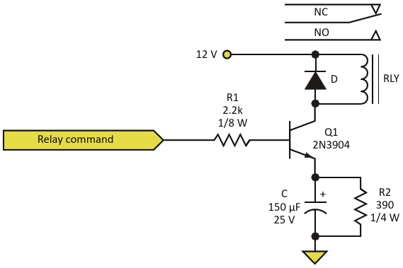

An RC circuit in series with the coil allows full-current turn-on for reliable relay operation, then reduces the current to save power
Darryl Widman
Simple Circuit Reduces Relay Coil Power
