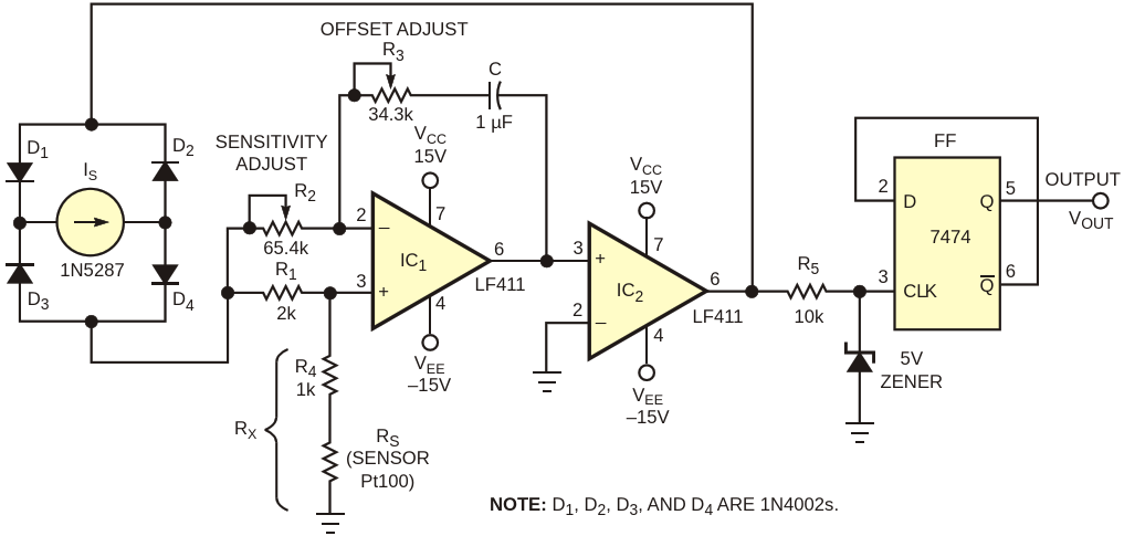

This simple circuit converts a resistance reading to a time period
S. Kaliyugavaradan, D Arul Raj
Circuit provides linear resistance-to-time conversion
Figure 1. This simple circuit converts a resistance reading to a time period
Figure 2. These waveforms represent the input and output of comparator IC
