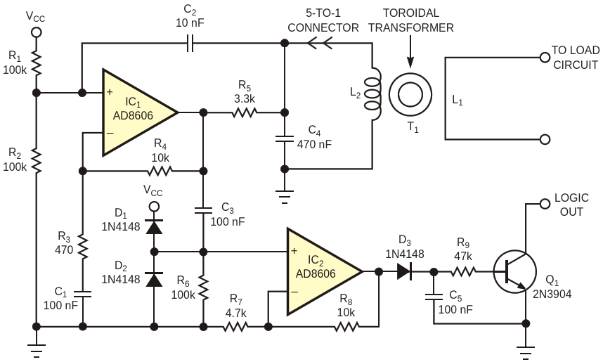

This sensor circuit operates …
This sensor circuit operates from a single 5 V power supply

Impedance Transformer Flags Failed Fuse
Figure 1
25 Kb
Figure 1. This sensor circuit operates from a single 5 V power supply
