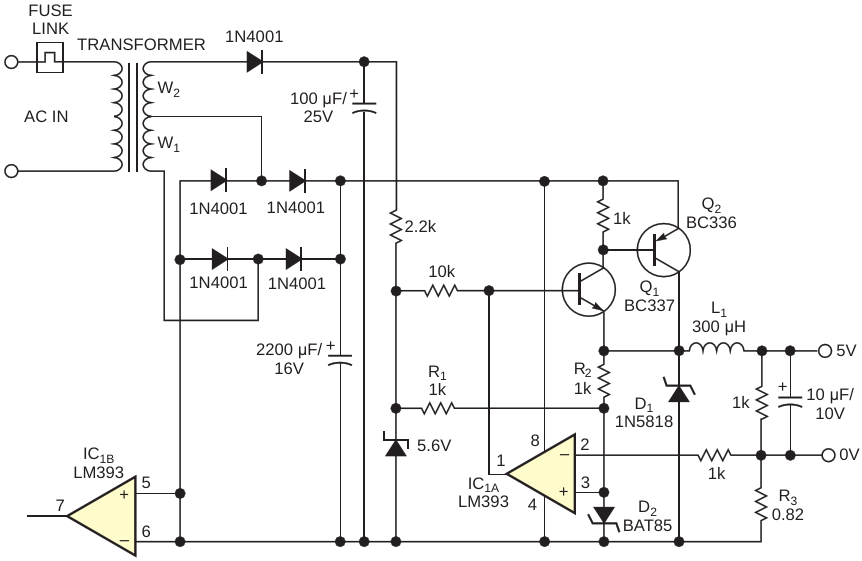

The addition of a few components protects Figure 1's circuit against overcurrent conditions

Figure 1. This simple plug-in power supply is effective but has no current limiting
Figure 2. Without switch-mode current limiting, the circuit of Figure 1 can crash and burn
Figure 3. The addition of a few components protects Figure 1's circuit against overcurrent conditions
Figure 4. Switch-mode current limiting restricts current in Figure 3's circuit to about 320 mA
