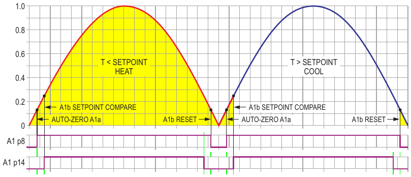

Temperature measurement/control cycle with two 8.33 ms cycles of thermostat operation where each of these cycles consists of four steps: autozero, setpoint compare, heat/cool and A1b reset
AuthorsStephen Woodward
Main DocumentArticle «Self-heated ∆Vbe transistor thermostat needs no calibration»
DescriptionFigure 2
File Format / SizePDF / 11 Kb
