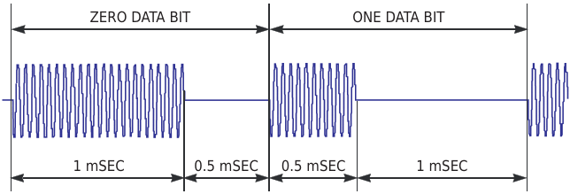

The DISEqC protocol specifies a bit time of 1.5 msec and these bit values

Figure 1. The DISEqC protocol specifies a bit time of 1.5 msec and these bit values
