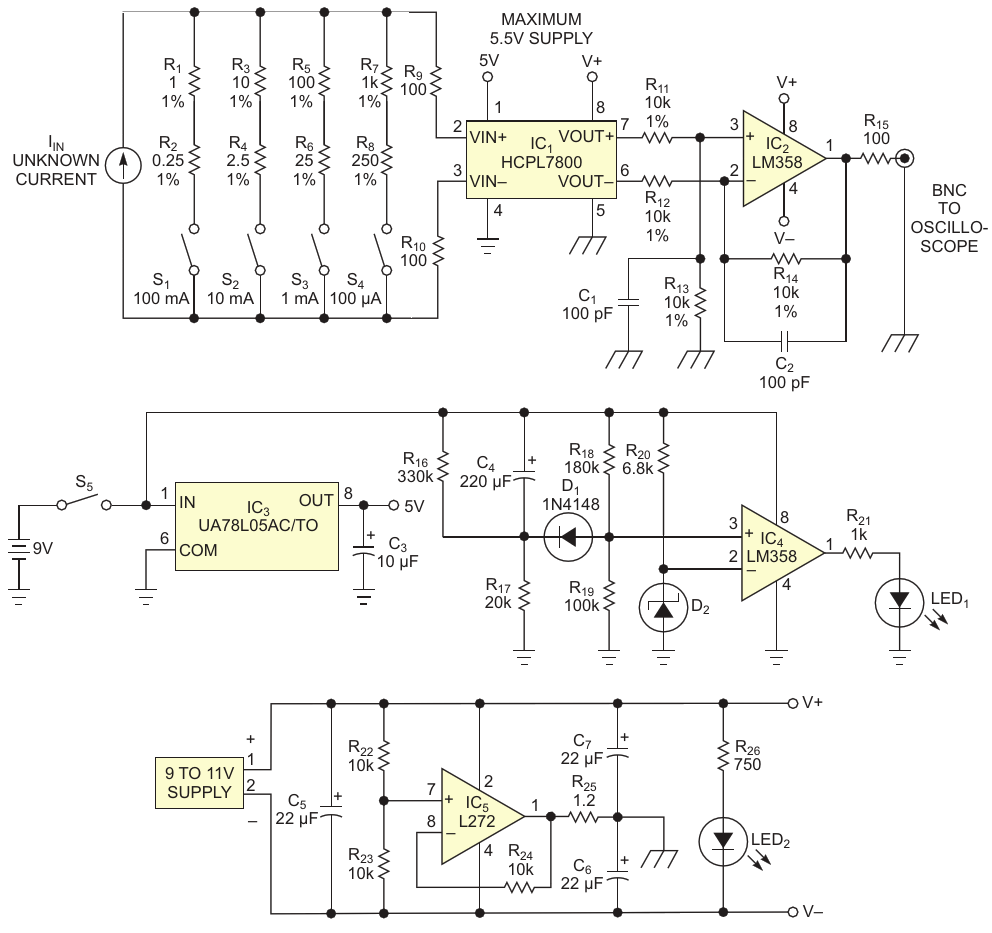

This circuit produces a …
This circuit produces a voltage proportional to current and isolates the oscilloscope from the measurement point
Anton Mayer
Circuit lets you isolate and measure current
Figure 1
