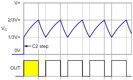

Figure 3. Added timing capacitor C2 immediately precharges C1 to V+/3 trigger level when RESET returns high normalizing the duration of the first oscillation cycle
Figure 4. C2 charge injection on oscillation startup equalizes pulse length
