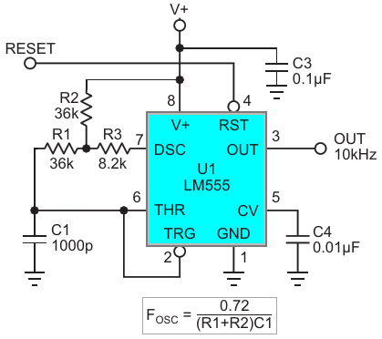

Bipolar 555 in gated 50:50 square wave configuration

Figure 5. Bipolar 555 in gated 50:50 square wave configuration
