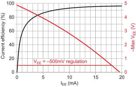

Output voltage and current …
Output voltage and current conversion efficiency vs output current for +V

Figure 1. U1 makes an efficient charge pump voltage inverter with comparator op-amp A1 providing programmable regulation
Figure 2. Output voltage and current conversion efficiency vs output current for +V

Figure 3. V
EE
= -500 mV is ideal for avoiding amplifier saturation without overvoltaging LV op-amps
