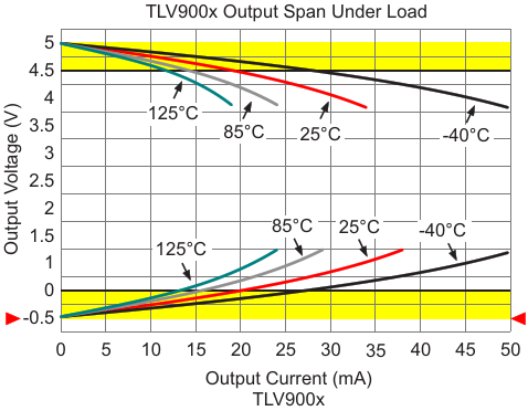

= -500 mV is ideal for avoiding amplifier saturation without overvoltaging LV op-amps

"Sub-zero" op-amp regulates charge pump inverter

Figure 3. V
EE
