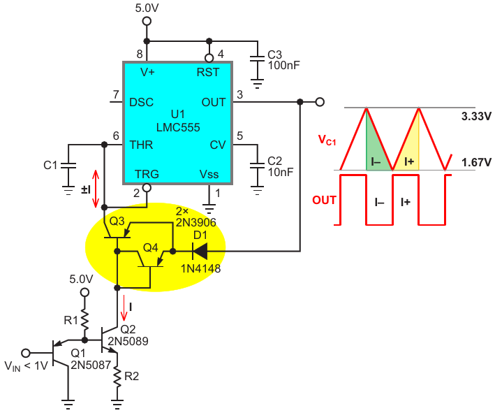

D1, Q3, and Q4 comprise the two-way current mirror. It passively conducts Q2's collector current to C1 via Q3's base-collector when OUT versus C1 is negative, but becomes an active inverting unity-gain current source when OUT goes positive and reverses th

D1, Q3, and Q4 comprise the two-way current mirror It passively conducts Q2's collector current to C1 via Q3's base-collector when OUT versus C1 is negative, but becomes an active inverting unity-gain current source when OUT goes positive and reverses th
