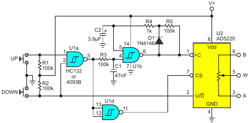

When a button is pushed down and held, the R5C2 time constant begins running. About a half second later, if the hold is still being held, the U1b multivibrator starts up, generating auto-repeating pulses at roughly 4 Hz for as long as the hold-down contin

When a button is pushed down and held, the R5C2 time constant begins running About a half second later, if the hold is still being held, the U1b multivibrator starts up, generating auto-repeating pulses at roughly 4 Hz for as long as the hold-down contin
