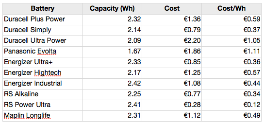

So far, I’ve captured the data from 10 brands of alkaline battery. In each case, I took 1 battery from the pack and measured its capacity. Obviously, it would be better to take a selection of each and average the results but I didn’t want to waste all my batteries on the test.
Batteries voltage and Time, using a similar load
Figure 4. Batteries voltage and Time, using a similar load
In most cases, I bought the batteries in packs of 4. It’s interesting to take the cost of each battery (pack cost / pack size) and combine that with the measured capacity:
This lets us compare each of the batteries in terms of the cost per Watt-Hour (which is really all you should care about when buying them). Obviously, lower is better:
Compare each of the batteries in terms of the cost per Watt-Hour
Figure 5. Compare each of the batteries in terms of the cost per Watt-Hour
There’s a difference of over 9X between the best value (RS Power Ultra) and the worst value (Panasonic Evolta).
