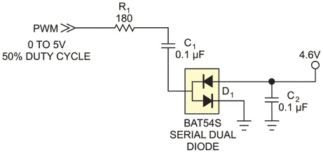

This Design Idea describes a circuit employing a small microcontroller-based sensor module with only three connections: 5V dc, an RS-232 transmit-data output, and ground. A dedicated single-voltage level shifter or a dc/dc converter would be too costly, but the design still needs to supply ±3V at 1 mA to drive the transmit-data pin. Because a spare PWM (pulse-width-modulator) output on the 5V microcontroller could drive ±5 mA at nearly 5V, a PWM-based voltage inverter using a BAT54S dual-series Schottky diode, two capacitors, and a limiting resistor would produce the negative voltage (Figure 1).
Voltage inverter employs PWM
Figure 1. The diodes and capacitors produce a negative voltage.
The microcontroller’s PWM output drives the inverter with a 1-kHz, 50%-duty-cycle, 0 to 5V waveform. When the PWM output is 5V, it charges C1. The lower diode in D1 biases in a forward mode to connect the terminal to ground. When the PWM output is low, it transfers the charge in C1 to C2 by forward-biasing the upper diode in D1. Meanwhile, it inverts the charge by taking the positively charged terminal of C1 nearly to ground potential. When the PWM output switches high again, the cycle repeats.
Due to D1’s minimum voltage drop of 0.2V, it is impossible to get to −5V from 5V, so the voltage output will be approximately −4.6V, with 0.2V loss in each phase. The design requires a limiting resistor, R1, only when the driving microcontroller is sensitive to the current transients when switching or if the switching transients disturb the analog inputs on the microcontroller.
