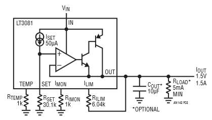

The regulator fixes current limiting and it has no adjustment. It is built into the IC and different devices must be used for different output currents. So, if the current limit needs to be matched to the application or accurate current limit is needed, an external circuit must be used. Figure 1a shows the basic architecture of older regulators. A new architecture was introduced in 2007 in the LT3080. It used a current source for the reference and a voltage follower for the output amplifier. Two advantages of this architecture are the ability to parallel the regulators for more output current and the ability for the regulator to operate down to zero. Since the output amplifier always operates at unity gain, bandwidth is constant and regulation is constant as well. Transient response is independent of output voltage and regulation can be specified in millivolts rather than a percent of output.

Basic Regulator Using the LT3081
