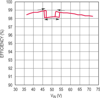

In telecom applications the input voltage has a wide (36 V to 72 V) range. Power converters that deliver a stabilized 48 V DC voltage to the loads are commonly used. The LT8705 can easily handle hundreds of watts at 48 V output voltage, at efficiency as high as 99%. Figure 1 shows one example with 5 A (240 W) output.
Buck-Boost Controller Delivers Hundreds of Watts with 99% Efficiency
Figure 2. The Efficiency of the LT8705, 48 V Converter Is as High
as 99% 240 W 48 V 5 A Telecom Power Supply.

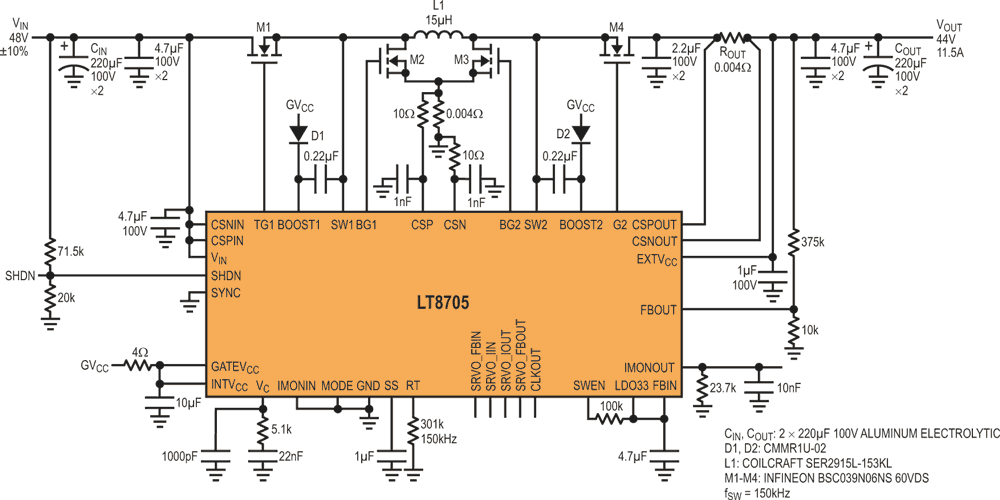

500 W Charger for 12S LiFePO4 battery
Figure 3 shows a circuit for charging a lithium iron phosphate battery from a 48 V (±10%) input voltage. The battery has 12 cells in series, so the maximum charge voltage is 44 V. This means that the circuit will operate in step-down (buck) mode most of the time, but at lowest input voltage it must operate in buck-boost mode.
Figure 3. LT8705 500 W, 44 V, 11.5 A Buck-Boost Converter for High
Powered Battery Supply.
At a 48 V input voltage the circuit has an efficiency of 99% at full load. The efficiency is high because only the input stage (M1, M2) is switching at high duty cycle and M4 is on continuously. The efficiency drops slightly if the input voltage is reduced to the minimum input voltage (43.2 V), as the LT8705 circuit then must operate in buck-boost mode when all MOSFETs are switching.
An external microcontroller can be used for the charge algorithm, and for controlling current and voltage from the LT8705 power converter.
