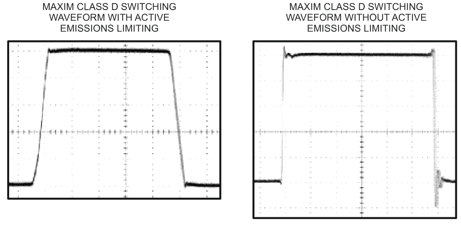

There are always electromagnetic interference (EMI) issues to consider when using a Class D audio amplifier in a design. If your system needs long speaker cables (over 1 m), it would be good to use a ferrite bead mounted to the speaker cable to reduce radiated emissions.
Simple Wireless Bluetooth Stereo Audio System for Outdoor Use
Figure 9. Maxim Class-D waveforms with and without active emissions limiting. The over- and
undershoots seen on the data at the right are sources of radiated emission.
Additionally, stereo amplifiers with Maxim's active emissions limiting technology make it easier to comply with EN55022B EMI limits. Active emissions limiting greatly reduces radiated emissions. The technology optimizes the output FET gate transitions, reducing over- and undershoots dramatically, to provide very good EMI performance without degrading the audio performance (Figure 9).
