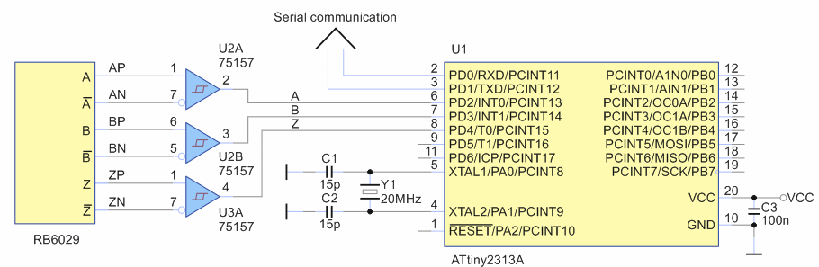

Reading quadrature encoder signals at high speeds (e.g., 1 MHz, or, 1 m/s with a resolution of 1 μm) often requires dedicated hardware. This Design Idea shows a simple scheme to accomplish this function using only an ATtiny2313A AVR microcontroller. Of course, the microcontroller can also be connected to other devices via the serial interface, or the measured position can be displayed on a local LCD, which could be connected to port PB. Additionally, one or more LEDs can be added to signal error conditions.

Figure 1. Reading quadrature signals with ATtiny2313A; the Z index signal is optional.
In this implementation, the interrupt handler is very important. It reads input signals A and B in less than 1 μs. Differential signals AP/N and BP/N are processed by SN75157 receivers, unneeded if your encoder outputs logic-level signals.
The processor is configured to generate an interrupt for any change of port PD pins. This interrupt is the last in the table of interrupt vectors, and hence can dispense with the jump instruction, resulting in a reduction in the interrupt service time of 2-3 clocks (100-150 ns).
An XOR operation between previous and current signals (AOLD ⊕ BNEW or ANEW ⊕ BOLD) determines if the current position has incremented or decremented from the previous. AOLD and BOLD are the A and B signals before changing state, and ANEW and BNEW are the values after the interrupt. The interrupt handler is in the PCIsubroutine1.txt file.

The interrupt handler checks for a new interrupt before exiting the current ISR. This case is signaled by setting bit T in SREG. Implementing this check, the execution time increases by 3 cycles. We have tested the operation of the subroutine using an RB6029 (4,000 pulses per rotation) at maximum speed, with no errors detected.
