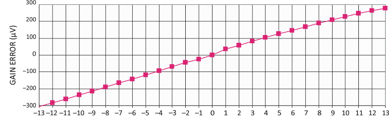

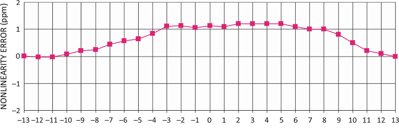

Thus, the circuit provides a precision gain of one-half with no external components and, in this configuration, is unconditionally stable. The performance plots of Figure 3 and Figure 4, respectively, show a gain error of less than 300 µV and a maximum nonlinearity error of about 1 ppm over a 26 V input-voltage range.
Precision divide-by-two analog attenuator needs no external components
Figure 3. The circuit in Figure 2 introduces a full-scale gain error of less than
300 µV over a 26 V input-voltage range.

Figure 4. The circuit in Figure 2 introduces a maximum nonlinearity error of about
