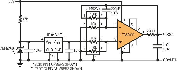

Accurate 50.00 V Reference
The LTC6090 is capable of 140 V output levels in single-supply operation, so amplifying a quality 5 V reference is a simple matter of using accurate resistor networks to maintain precision. The LT5400 precision resistor array handles voltages up to 80 V, so utilizing the 10:1 ratio version for a gain of 10 is an easy way to produce an accurate 50 V calibration source without any adjustments required. Figure 1 shows a circuit amplifying the LT6654A 5.000 V reference to 50.00 V with better than 0.1% accuracy. The circuit may be powered from 55 V to 140 V, with 65 V being a useful supply voltage furnished from the optional portable supply shown as part of Figure 2.
High Voltage CMOS Amplifier Enables High Impedance Sensing with a Single IC
Figure 1. High Voltage Precision Reference.
The LTC6090 is set up with a 1 μF output capacitance to provide excellent load-step response. The capacitance is isolated from the op amp with a resistance that forms an effective noise-reduction filter for frequencies above 700 Hz. The precision LT5400A-3 resistor network provides 0.01% matched 10 k/100 k resistances that, along with the absence of loading by the high impedance CMOS op amp inputs, forms a highly accurate amplification factor. Input offset voltage of the LTC6090 contributes <0.03% error, while the LT6654A contributes <0.05%. The entire circuit of Figure 1 draws about 4 mA of quiescent current and can drive 10 mA loads.

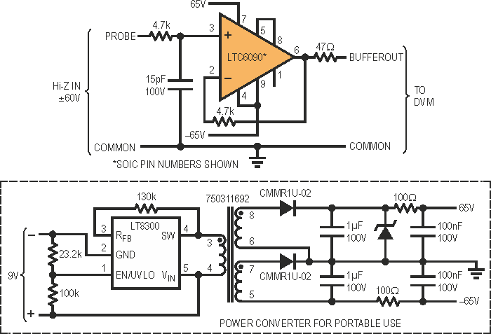

Simple Large-Signal Buffer
The LTC6090 behaves as an ordinary unity-gain-stable operational amplifier, so constructing an electrometer-grade buffer stage is simply a matter of providing 100% feedback with the classic unity-gain circuit. No discrete FETs or floating biasing supplies are needed.
Figure 2. Buffered Probe for Digital Voltmeter.
As shown in Figure 2, the LTC6090 can easily be powered with a split supply, such as a small flyback converting battery source. This basic circuit can provide precision measurement of voltages in high impedance circuitry and accurately handle signal swings to within 3 V of either supply rail (±62 V in this case). With input leakage current typically below 5 pA, circuit loading is essentially inconsequential (OS) for source impedances approaching a gigaohm. The useful full-swing frequency response is over 20 kHz.
