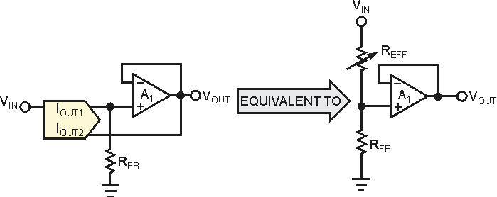

Figure 1. This simple circuit avoids a phase inversion and operates with
a single supply. In this configuration, the DAC acts as a
digitally programmable resistor.
Figure 1 shows a way to rewire this simple circuit to avoid the phase inversion and to operate with a single supply. In this configuration, the DAC acts as a digitally programmable resistor, and the DAC’s code changes the effective resistance between the input voltage and the IOUT1 output-current terminal of the DAC. Figure 2 shows a practical implementation using one-half of an Analog Devices AD5415 dual 12-bit current-output DAC operating as a voltage divider. This figure omits the DAC’s control lines for clarity. Op amp A1 forces the voltage on the IOUT2A output-current terminal to follow the voltage on the IOUT1A output-current terminal. This approach prevents a voltage differential from developing between these two bus lines, which would result in the application of different gate-source voltages across the internal DAC switches and a deterioration in the DAC linearity.

Wire the split-feedback resistors, RFB and R1, to produce a composite-feedback resistor equal in value to the DAC’s ladder impedance, R. For this arrangement the circuit-transfer function is
where REFF is the effective DAC resistance that is under digital control. Its value is
where n is the resolution of the DAC and N is the binary equivalent of the digital-input code. Substituting the second equation into the first and assuming zero DAC gain error, the circuit-transfer function for a 12-bit DAC reduces to
With all switches off, the effective impedance between the reference voltage and the IOUT1A terminal is infinite, so the output voltage starts at 0 V when you load zeros into the DAC. The output voltage increases linearly with increasing code, ideally to approximately half the input with all ones applied to the DAC.
