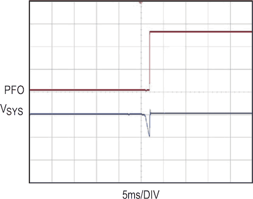

Figure 2 illustrates the entire switchover process. At the start, the system load is supplied by the LTM4607, as the input voltage is present. When the input voltage is interrupted, the LTC3643 supports the system load by discharging the storage capacitor. Figure 3 shows the timing of the switchover in more detail. The load voltage falls to 10 V, a value set by the resistor divider RPT/RPB and then recovers to the nominal 12 V, set by the resistor divider RBT/RBB.
Electrolytic Capacitor-Based Data Backup Power Solution for a 12V System Regulated from 5V to 36V Input
Figure 3. Detailed View of Switching Waveforms (PFO 1V/DIV, VSYS 2V/DIV).
