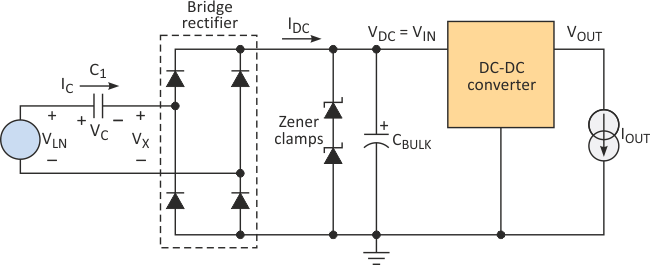

Low-power applications such as e-meters (electricity or energy meters) often require a simple ac line-powered supply where a 3.3-V rail powers a microcontroller and charges a lithium-ion battery to 4.2 V. You can implement this with a mains-frequency power transformer or with a more complicated ac-dc (offline) power supply. Both approaches have well-known disadvantages related to a combination of weight, size, and complexity. Two simpler options are a full-wave capacitor-drop circuit with the bridge rectifier (Fig. 1) and similar half-wave circuit.
Approach Implements Offline Power Supply for Light Loads
Figure 1. No transformer is needed in the full-wave capacitor-drop circuit using a bridge rectifier.
The reactance of line capacitor C1 determines the maximum current.
The front end of these circuits is known as a “capacitive-dropper” or “cap-drop” topology. The idea behind both the full-wave and half-wave implementations of this circuit is that line capacitor C1 acts as a lossless resistance, and the reactance of the capacitor will set the maximum current that can be provided to the input of the dc-dc regulator.
The Zener diodes clamp the input voltage to the dc-dc converter under no-load conditions, thus converting the mains voltage to an intermediate dc rail (VDC). The input voltage to the dc-dc converter (VDC = VIN) is set to a relatively high value so that the current required from the cap-drop will remain low. You can then downconvert the intermediate unregulated dc rail to the regulated dc voltage required by the load by using a buck regulator with a wide VIN range.
A high step-down ratio allows for a lower input current to the regulator, and is possible with devices such as the LMR14006, LMR16006, and LM46000 buck regulators. This higher ratio enables you to use a smaller value of C1, resulting in lower apparent power drawn from the mains. Applications such as smart-grid e-meters can benefit from this feature because of strict regulations on the maximum apparent power consumption; the typical maximum is limited to 8 VA.

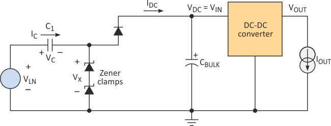

Figure 2 shows the implementation with a half-wave cap-drop circuit. Since the half-wave circuit will disregard the negative cycle of the line voltage, this will result in a lower current delivered to the input of the wide VIN buck topology than in the full-wave circuit. Thus, for applications like battery charging, where a faster charge would require a relatively higher load current from the dc-dc regulator, the full-wave circuit is preferable.
Figure 2. The half-wave circuit delivers lower current to the input of the wide
VIN buck topology than the full-wave circuit can supply.
