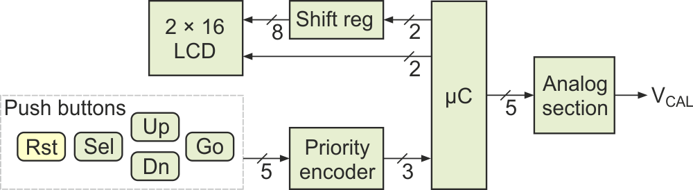

Figure 1 shows the block diagram of the calibrator. Five push buttons and a two-line display allow the user to set a voltage from –5 to +10 V with 100 µV resolution. The µC (microcontroller) also controls the analog section, which includes a high precision DAC (digital-to-analog converter), two analog switches, two op-amps, and four matched resistors. The whole circuit needs 12 I/O lines from the µC. The power supply is ±12 V.

Figure 1. The calibrator has a simple user interface and requires only 12 I/O lines from
the microcontroller in my implementation. More available I/O pins would allow
further simplification.

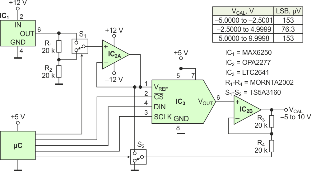

Figure 2 presents the analog section of the calibrator. The key part is the LTC2641, a 16-bit DAC from Linear Technology with differential and integral linearity of ±0.5 LSB each (typical). Offset and gain errors are 2 LSB max. and ±2 LSB typical, respectively.

Figure 2. Three precision ICs, four matched resistors, and a microcontroller build a DC calibrator
with 16-bit resolution and 70 µV error.
The other parts in the circuit are of corresponding quality. The MAX6225 is a 5 V reference with 1 mV (200 ppm) tolerance and 2 ppm/°C drift. The OPA2277 is a dual high-precision op-amp with a maximum offset of 10 µV and drift of 0.1 µV/°C. The four 20 kΩ resistors are matched with ratio tolerance of 0.01% and temperature coefficient of 25 ppm/°C. The on-resistance of the analog switches is only 1 Ω; 0.005% of the value of the matched resistors (important for resistor R4).
S1 & S2 enable four ranges: 0-5 V, 0-10 V, ±2.5 V, and ±5 V, with resolution of 76.3 or 153 µV. The µC automatically selects the best range for the desired output.
Operation is simple and intuitive. The Reset (Rst) button resets the output voltage to 0.0000 V. The Select (Sel) button selects a character (sign or digit) on the display and makes it blink. The Up and Down (Dn) buttons modify the value of the blinking character. When the Go button is pressed, display stops blinking. Other control arrangements can of course be implemented.
The µC calculates a 16-bit number, sends it to the DAC, and controls the analog switches. Error messages are displayed when the desired voltage is less than –5.0000 V or greater than 9.9998 V.

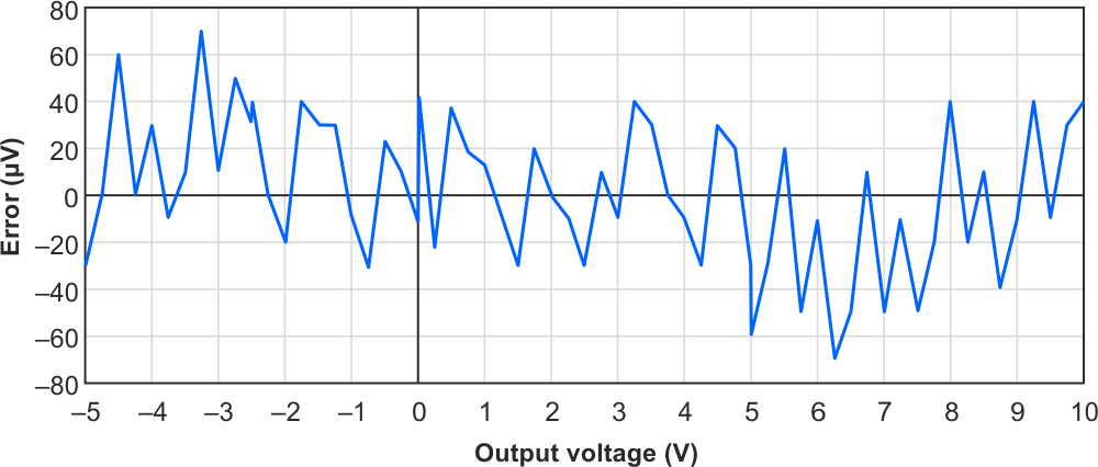

Circuit performance was tested with a 6.5-digit DMM from Keysight. As Figure 3 shows, the maximum error is ±70 µV, half of the 153 µV resolution of the circuit for the 10 V spans (0-10 V and ±5 V). For the 5 V spans, resolution drops in half and the error follows at ±40 µV max. These are the minimum possible values one can obtain with a 16-bit DAC and a 2.5 or 5 V reference. Errors fit well the 100 µV resolution of the display. Noise was under 1 µV.

Figure 3. A 64-point calibration shows absolute error of ±40 µV for the
5 V spans and ±70 µV for the 10 V spans.
