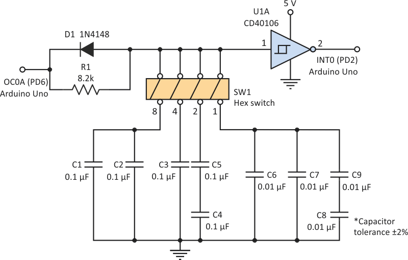

PWM output OCRA of the Arduino Uno forms the input to the circuit (Fig. 1), with the output connected to the interrupt pin INT0.
Hex-Switch Decoder Uses Weighted-Capacitor Network to Reduce I/O Pin Count
Figure 1. The functional block diagram consists of a hex switch connected to the weighted-capacitor
network, charging resistor R1, discharge diode D1, and the Schmitt inverter.
Capacitors in the ratio of 8:4:2:1 are selected by SW1, then charged through R1 during the high-state portion of the PWM signal and discharged through diode D1 on the low-state. At the start of the charge cycle, the output of the Schmitt inverter, U1A, is high; it changes to low when the capacitor voltage reaches the upper threshold of the Schmitt inverter. This negative-going edge is used as an interrupt to the processor.

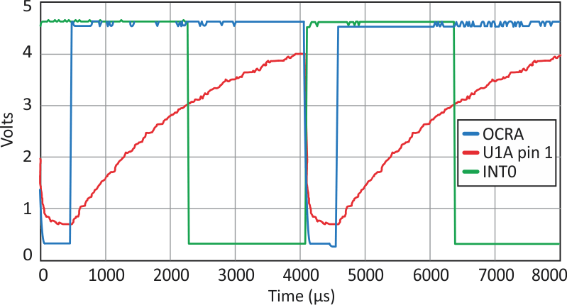

The Arduino Uno, operating with a 16-MHz clock, is programmed to use Timer0 to set up the PWM output OCRA at 244 Hz with the pulse-width set to 224/255 cycles. Figure 2 shows the waveforms when only switch #8 of the SW1 is ON. Parallel capacitors C1 and C2 are charged by the high-state output V-high of OCRA, and the Schmitt inverter changes state at the input upper-threshold of approximately two-thirds the supply voltage. This negative transition uses INT0 to interrupt the processor, which then reads the current value of Timer0.
Figure 2. The Arduino PWM output OCRA charges the weighted-capacitor network, generating
INT0 at the Schmitt trigger’s upper threshold of approximately 3 V.

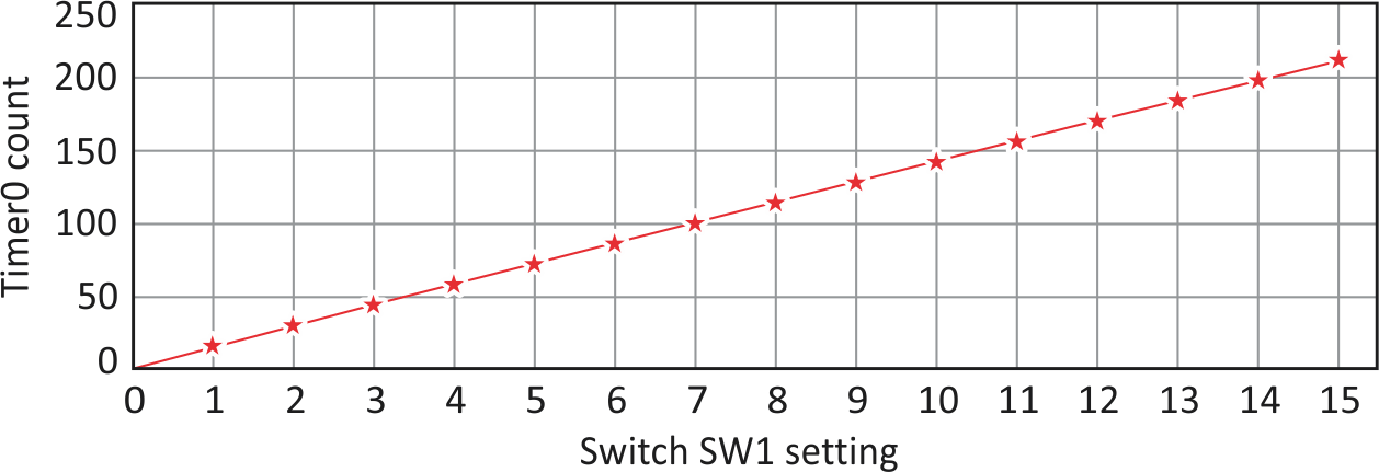

As shown in Figure 3, the count values captured at the different interrupts corresponding to the 16 combinations of SW1 reveal a fairly linear characteristic, with a count difference of about 14 between settings. A software routine that permits a maximum-tolerable difference of ±6 with respect to nominal mid-values is used to decode the switch positions.
Figure 3. The count values seen at the different interrupts that match the 16
combinations of SW1 show a good linearity of the result.
