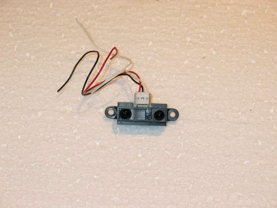

1 Sharp GP2D120 IR Sensor - 11.5" / Analogue
11.5" or another range will do. Only do not buy the "œDigital version" of the Sharp sensors for this kind of project, they do not measure distance as the analogue ones does.
Price: 10 USD
Be sure to get the red/black/white wires for it. This is not allways included, and it is a non-standard socket!
This is actually not a favorite of mine, I usually use ultrasonic sensors, such as the SRF05 (find it anywhere via Google - they also sell it at the picaxe-store picaxe-store where they call it SRF005 and have a picture of the back of an SRF04 in the shop! But it is the right one, and I did tell them but..). Anyway; The SRF05 is much more reliable and precise. It is also faster, but costs a little more, is a little more complicated to write code to, and a little more complex to install - so it is not used here, but if you are fresh, buy one of these instead ;)
If you go for the SRF05, I have made a small walkthrough to connecting the SRF05 here on letsmakerobots.com

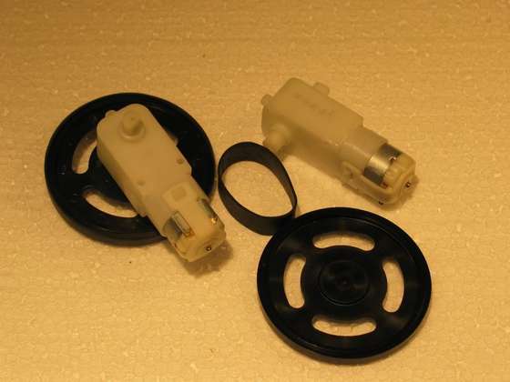

2 Gear Motors with wheels
The higher the ratio, the stronger robot, the lower, the faster robot. I recommend ratio somewhere between 120:1 to 210:1 for this kind of project.
Price, total: 31 USD

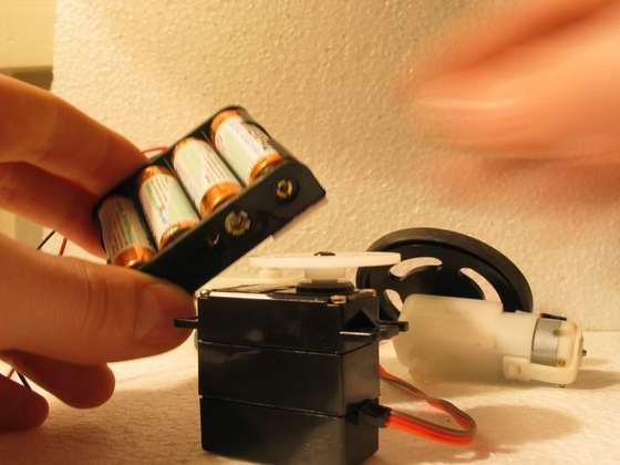

First mount the wheels to your geared motors. And add tires (rubber bands in this case).
An easy way to mount stuff for fast (and amazingly solid and lasting) robots is double adhesive tape
Insert the batteries, so you have a realistic idea of weight and balance.
When batteries are below the axel of the wheels you can make it balance, but it is no problem if it does not.
Add some double adhesive tape to the button of the server as well, and..
Chose your own design, you can also add extra materials if my “design” is too simple.
Main thing is that we have it all glued together: Batteries, Servo and wheels. And wheels and servo can turn freely, and it can stand on it´s wheels somehow, balancing or not.
Take out the batteries, to avoid burning something unintended!

Now let´s hook up “the head”, the Sharp IR-sensor. (or SRF05 if you went for that option)
(If you bought an SRF005 or similar instead, you should look here on how to hook this up, it is different from this!)
There are a million ways to hook up a thing like the Sharp IR-sensor, but here are clues:
Red needs to be connected to V1, that is (in this setup) anything marked “V”, or is connected to this.
Black goes to G, anywhere on the board.
White is to be connected to Analogue input 1.
If you read the documentation that comes with the project-board, you can read how to attach the accompanying ribbon-cable, and use this.
What I have done on the picture, is to cut off a cable from an old burned out servo, soldered in a pin, and connected the whole thing just as a servo. You can use it to see which colors of the Sharp goes to which row on the board.. or one way to do this.
Weather you use the ribbons or “my method” of connecting the Sharp IR, you should also connect the 3 remaining analogue input to V. (look at the little pins connected on the picture, next to the plug)
I had some jumpers laying, and you can see that all 3 connections left are short cut. (The last pair, not touched, are just two “Ground”, no need to short cut these). If you use the ribbon, you can just connect the inputs to V (or ground for that matter) by connecting the wires in pairs.
The reason it is important to shortcut the unused analogue inputs here is that the are “left floating”. This means that you will get all sorts of weird readings where you try to read if these are not connected. (to put it short, this is a semi-fast paced walkthrough, we must get to the end ;)

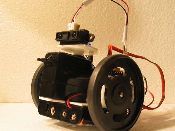

Now for some fun!
Some how you should get the Red wire from your batteries (+) hooked up to the red wire on the project board (V). And the black (-) to (G).
How you do this depends on the equipment you bought.
If there is a battery-clip on both batteries and board you should still make sure that the "+" from the batteries ends up to the "V" on the board. (Learn more here)
Sometimes (though not often) the clips can be reversed to each other, and just putting two matching clips together is no guarantee that + gets to V and - gets to G! Make sure, or you will se melting things and smoke! Do not feed the board with more than 6V (no 9V batteries, even though the clip fits)
As a note; We are only working with one power-supply here. Later you will want to use same Ground, but both V1 and V2. That way your chips can get one source, and the motors etc another (stronger) voltage.

Stick on the “head” - the Sharp IR
You have actually made a robot. Now the fun starts, you can program it to do anything, and attach anything to it, expand in any way. I am sure you are already full of ideas, and you are likely not to have followed me all this way ;)
The design may wary, you may have used other parts etc.. But if you have connected as described, here are some tips to get started programming your robot:
