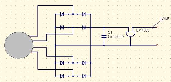

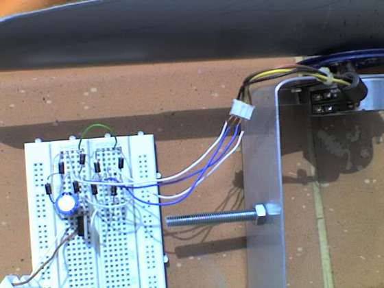

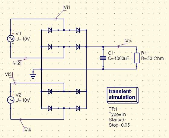

Since stepper motors generate alternate voltage you need to rectify it. Each phase must be rectified with 2 diodes, this is, 8 diodes.
The output of the rectifiers will be stabilized with a 1000 uF capacity and a 5 v voltage regulator (LM7805 in my case).
Attach some connectors to allow charging different gadgets. I added a female USB connector since my phone and mp3 use USB to charge.

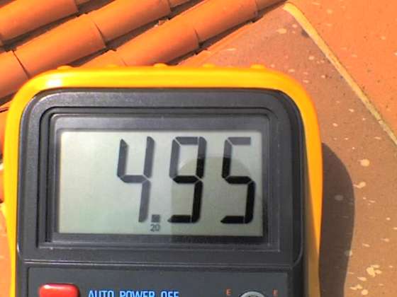

Note 1: this motor can generate easily more than 5 V, but i only need 5 V by the way.

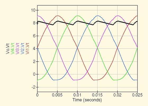

Note 3: I used this free software for circuit simulation: QUCS
It lacks of some components right now, but it's great after all.

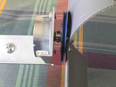

 I made the blades using the Chispito instructable.
Check it now!
 made the blades
I don't have plans of the structure, since I thought it while cutting it :)
Take my photo as help.

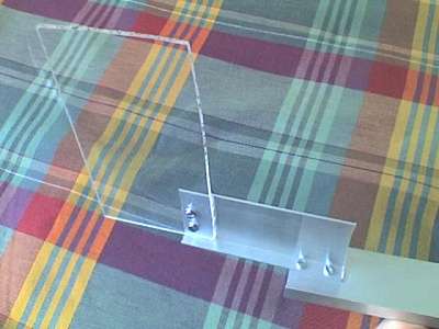

I must rebuild the rudder, since it's too small.
I'll post pics of a new one soon
