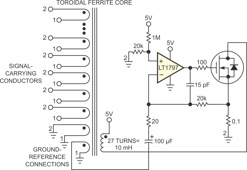

However, the Achilles’ heel of the CMV transformer is the fact that the decibels of cancellation fall off at the low-frequency end of the noise spectrum. This situation occurs because noise cancellation depends on the fact that the inductive reactance of the windings must be much larger than the impedance of the cable. Hundreds of millihenries of inductance are necessary to satisfy this criterion for frequencies as low as 60 Hz. For multichannel applications requiring cancellation for frequencies as low as 60 Hz, this fact translates to lots of copper, core, bulk, and weight. However, if you don’t mind if your designs consume a little power, then a work-around exists: actively driving the CMV core.
Actively driven ferrite core inductively cancels common-mode voltage
Figure 3. Using the active drive of the CMV core, you can achieve CMV reduction
of 40-dB or more cancellation, extending from tens to millions of hertz.
In Figure 3, the power amplifier comprising the LT1797 high-frequency op amp and MOSFET forces the driven core to precisely cancel CMV as sensed in the ground-reference connection. The result is such a large multiplication of the apparent winding inductance that you can reduce the “windings” to a simple single pass-through of the toroid core. In other words, you need to thread a multiconductor-signal cable only once through the “hole in the doughnut” to achieve CMV of 40-dB or more cancellation, extending from tens to millions of hertz.
