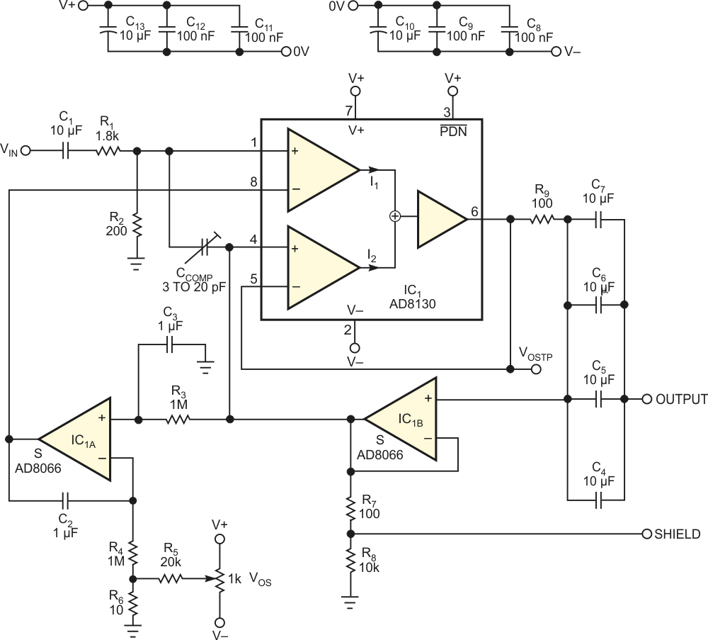

Bipolar current source maintains high output impedance at high frequencies
Figure 3. For an ac-coupled current output, add a dc-stabilization loop, IC2A and IC2B.
Current sources that have capacitance-coupled loads benefit from a dc servo loop to stabilize the circuit's operating point (Figure 3). The value of output-coupling capacitor CO depends on the desired low-frequency roll-off characteristic. Further improvements of the basic circuit enable compensation of output capacitance and increase the circuit's output impedance. A small, adjustable feedback capacitor, CCOMP, that's approximately one-half of the output's stray capacitances provides feedforward compensation and further reduces the effects of stray capacitance at the output (Figure 4). To prevent oscillation, the cable's shield-driver circuit's gain should be slightly less than unity. Note that reducing the output-current-sense resistor, R9, to 100 Ω compensates for the input attenuator formed by R1 and R2 and maintains a 1-mA/V characteristic. This voltage-to-current source's frequency range spans 20 Hz to 10 MHz. For best results, use high-frequency circuit-layout and power-supply-bypassing methods.
Figure 4. The complete circuit includes trimmer capacitor CCOMP, which compensates for
stray capacitances in the circuit's packaged layout. Also, note sideband treatment
of power-supply bypass capacitors.
